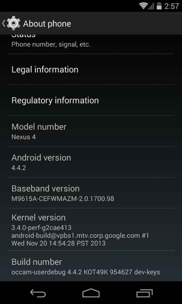

Hi. I just purchased a new Nexus 4 from Amazon and it has 4.4.2 ROM. "Check for update" button does not update to 4.4.4. Any help is greatly appreciated. Thanks in advance.
OK. This seems bad. But I don't really know too much at this point.

If you go to menu>settings>about phone what is the build number you are showing? You should always be able to flash a stock rom and get everything working.

I know. I suspect fishy, that's why I wanted to see the build number.

Before I did anything else, I would make sure the IMEI number is good. Even if it's good now, it could get blacklisted later if there's funny business going on. Then you're stuck with a brick. I'd send this back in a heartbeat. Have you put in a SIM and activated it?
Just noticed something bad. I trusted Amazon and did not look at the Imei on the Sim card tray which does not match. Something is fishy. Stolen Imei?
