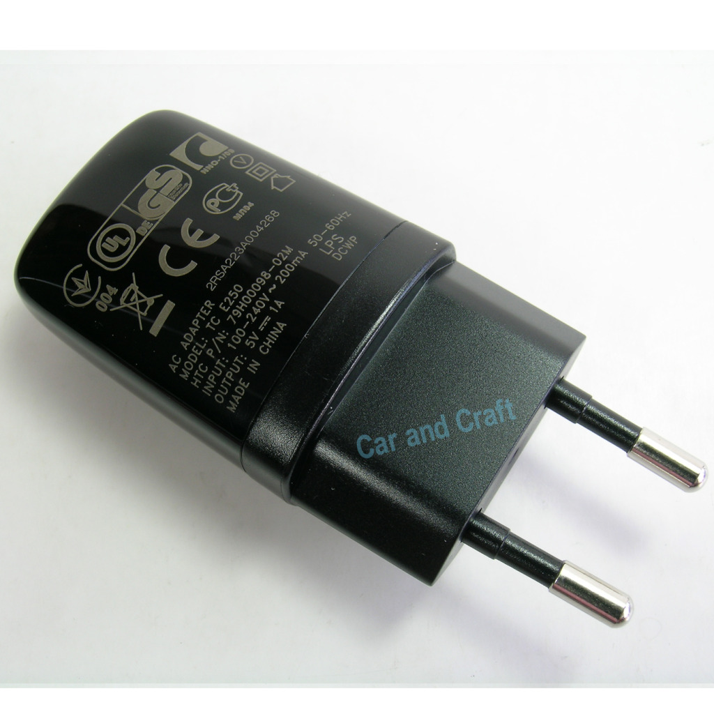

With that i mean i get no more then 66% of 100% total battery power (tested 12Hr) on my Note 3 if i use my old "original charger for HTC Incredible S" (That does work perfect with my HTC)
One night i put the note 3 on charging when i had 80% when i got to sleep, and when i woke up i had 15% less battery.
Wifi is always on, on my phone!
One strange thing is that it says its 100% done, but when removing the HTC charger from phone it takes 2-3 sec, then it goes down to 44-64% always, even if charging for 12+ Hr. (Only with HTC charger)
If i use Note 3 original charger i never have this problem, even with a normal usb 2 cable that is extra long.
Original HTC Charger info that don't fully charge my Note 3, only up to 44-64% maximum:
Input: 200mA
Output: 5V 1A

That is your issue right there. The HTC Incredible S AC adapter is only 1Amp. Samsung Note 2 even required a 2 amp charger.
You might want to browse through the note 2 accessories thread. There were several ac adapters that were posted with 2amp.
Your micro usb chord should work fine, as long as you have a 2 amp ac adapter base.

You asked what the problem is and the problem is simple. Your old htc ac adapter wasn't made to handle a higher powered device. After purchasing 2 amp base, that should work for future devices, unless the devices start to get even more powerful later down the line.
