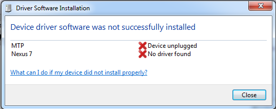

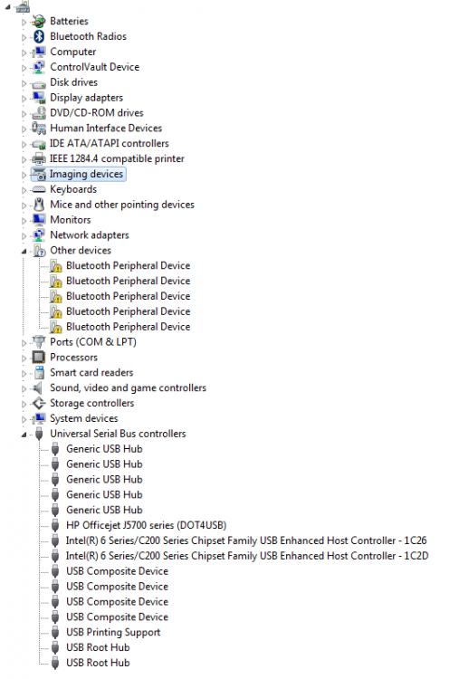

Hello everyone,
I am having trouble having my Nexus 7 (2013) viewable on my PC. I have read a bunch of threads on this, but nothing has seemed to help. Here are the supposed causes, and what I have tried.
1. USB cable is charge only - My LG phone shows up as a drive using the same cable.
2. Install Google USB drivers - Nexus does not show up on Device Manager anywhere
3. Uninstall all Android drivers, then plug it in - I used USBDeview and uninstalled anything with Google, Android, or Nexus. Then when I plugged it in, I get what is in image 1.
4. Tablet is busted and won't show up - When i plug it into another PC, it shows up fine. Just not this one.
Can someone help me figure out what is going on, or at least allow it to show up in my device manager. I have run out of ideas. Thank you.

Rather than look for it in Device Manager, look for it in Windows Explorer. If it connects properly it will show up following the drives under Computer and under any mapped network drives and will show as Nexus 7.

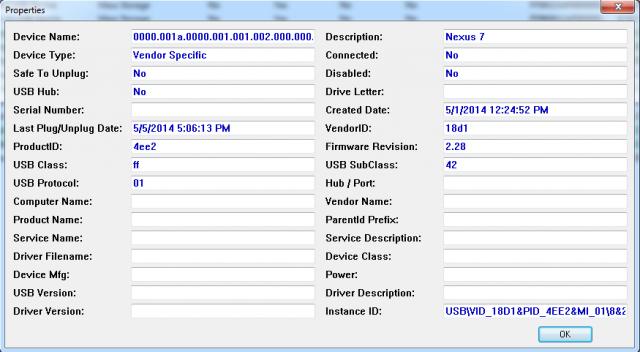

It does not show up in explorer. I opened the properties of the driver that is visible in USBDeview, and took a screenshot of it and attached it. Does that help at all?

I am not familiar with USBDeview, so no help. I just checked mine and it does show up in Device Manager under Portable Devices, as well as showing up as previously described in Windows Explorer. I also looked for a place to describe what happens when you connect it to a computer, but found nothing like that. My phone does have a Connect to PC setting, but that's an older version of Android. Sorry I can't help.
