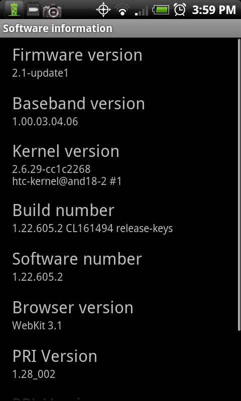

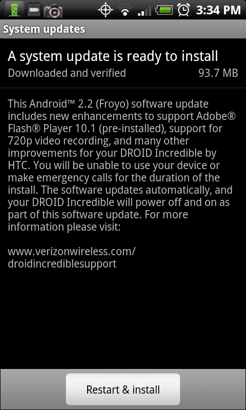

Alright I copied the guide that was on Droid-Life and on XDA. I have rooted with unrevoked3 and got s-off with unrevoked forever. I have already removed clockworkmod recovery and now have the stock recovery. All my settings match what the thread said and it keeps on aborting the update. Can anyone help me?

if you have the stock recovery idk. just double check. im sure you already know how. but reboot into hboot, power off. and back on by holding vol down and power, then push vol down to get to recovery and push power. if you get the red exclamation point you have stock, if you get anything else its custom.
yea i double checked. i have everything stock. it will find the update, open the update, install the update, verify the current system, then installation aborted.
yea i guess. it says to check "system\app\cityid" and a bunch on numbers after city id. then says installation aborted.
well i thought it had something to do with cityid so i tried to move it back. i moved it from "system\app.disabled" to "system\app" but it said permission denied on cmd. so i removed it using root explorer and i did. retried the update and says the exact same thing even though cityid was removed from the system. dont know whats going on but i might just download the official leak or a different ROM instead.
so i did a factory reset to see if that fixed the problem and it didnt work either. kept on saying the same thing. so it sucks to be me. waited for the official update since i didnt want my phone to wiped clean and i get rewarded with no FROYO. boohoo!!! so freaking happy to come home from class to install my FROYO now im pissed.
You made changes to your install (despite the claim of "everything stock") and that is preventing you from updating.
You need to restore CityID.apk. You need to do this either from recovery or via S-OFF and remounting your system partition rw. But even if you do this, what other changes that you haven't mentioned did you make to your "everything stock" system? If you don't tell us what you did, how can we help you undo it?
If you don't know what changes you made, your best bet is to RUU back to stock and start from scratch.
