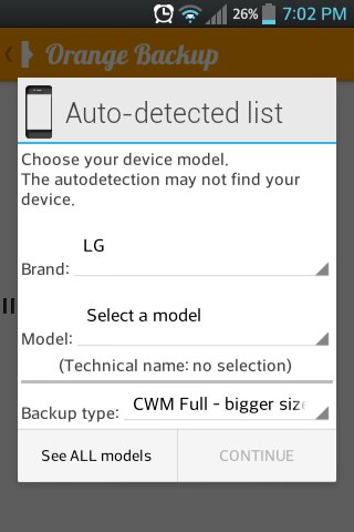

What do I put for "brand" and " backup type".?
