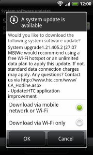

Yesterday I was pinged regarding the update (see pics). As I wasn't sure whether the update would affect rooted phones adversely, I declined. :o

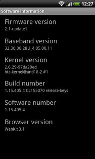

I did notice, however, that the version in Nimbu's root image was lower than the one on the phone, so maybe it's just trying to bring me back up to where I was before rooting.
So, my question is also, does the update affect rooted phones adversely? :confused:
Will the phone be un-rooted by accepting this update, or will it be the situation but with a newer firmware?

When I tried applying the OTA update to my rooted Hero, it just failed on reboot presumably because of the different bootloader.
I too have a Desire that I rooted using Lekky's guide. I got halfway through downloading the firmware update today but suddenly thought perhaps it would mess up or un-root my phone. So if anyone knows if it is safe to install this update on a rooted Desire or not please let us know!
From reading other threads, it looks like this is a minor update that will mess up the Wifi. I downloaded it, but then hit some button (back maybe) and it disappeared. I went into my file explorer and just deleted it. There was an option to discard (or install later). I figure, it works fine enough for me now. I'll wait until Froyo comes out to make major changes.
Tim
Yes the 1.21 update does cause problems to rooted desires ie it stop wifi from working. You can get it to work using your goldcard but only if your phone has been unlocked, otherwise IT WILL SIMLOCK your phone
