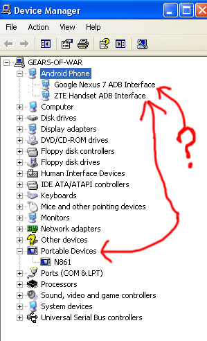

And I see that the device manager creates a "portable devise" to interface with the Phone for instance, (only when the phone is plugged in), while not with the tablet. Plugged in the phone and tablet become "Android phone" and under that, the actual device is named ... i ZTE ADB interface Or Nexus 7ADB Interface .

MTP isn't built in to WinXP. Sorry if this is a duplicate but just in case - How do I install the MTP drivers for Windows XP? - Microsoft Community
:o
I'm finding this very helpful the link I followed to get the MTP drivers, and then the idea led me on a google look-up, and found this thread, with an interestingly similar problem, and kind-of odd solution.
http://forum.xda-developers.com/showthread.php?p=32260564
I seems they found success, by turning OFF, debugging during driver installation.
I'll be trying several other things, and will get back.
Thank you.
Question: Was the N7 plugged into the PC when it crashed?
Reason being, is when I first got a flash drive, I was running Win XP. I powered down the PC, then unplugged my USB stick and went home. Next day got to work and powered the PC on, wouldn't recognize the Drive. I tried to change the drive letter, everything. No Go.
I figured out eventually, that I needed to power down the PC, and plug the drive in while it was powered down, then boot the PC up. Once I did that, it recognized the drive.
Not sure if this is related to your issue, or even if my story helped in any way. I tried, and hopefully it helps. :)
