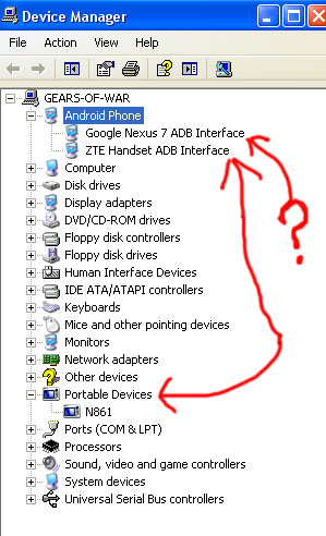

Buy the way, I don't get a yellow MTP icon in Hardware/device manager, instead, the ADB for Nexus7 is shown correctly as installed (above), but midway down are yellow "other device's" :
Ethernet Controler, and ..
Multimedia Audio Controller
These I established long ago, ARE the Nexus7, but are not being given what? Correct driver's? It's been a long time, but the drivers it seems, have repeatedly proven to be indigestible by this incarnation of WinXP and Service pack3.

I have noticed that the link isn't particularly stable if you are trying to transfer large size or large amounts of files. Best transfers are multiple small ones. When it would hang up, I'd just unplug the tablet, wait for the audible tone that it was dismounted then plug it in again and continue.
BTW, regarding not seeing the yellow MTB icon in device manager, make sure your tablet is pluged in and unlocked while you're attempting this mod.
