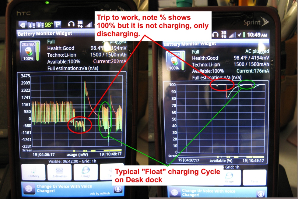

After going through all of the investigations I listed above, I went out and purchased a 2A charger. This changed the behavior slightly. Now when I am charging, it will charge all the way to 100%. The green light will come on and stay on. However, if I leave it on the charger, it will discharge down. When I remove it from the charger, the green LED goes off, and the battery level will immediately drop. For my standard trip to work, it typically will discharge down to about 80% before I place it back on my dock at work.
I've been using Battery Monitor Widget to see the current draw during discharge and charging. It is very clear what is happening.
Previously, the EVO was overheating during charging. This would stop the charging cycle, which wouldn't start back up.
This started happening about the same time that Gingerbread came out, so I am guessing that they may have introduced a bug to the charging logic in the Kernel.
I am waiting for the Gingerbread Kernels to be released so I can see if someone may be able to help locate the bug.
I've put together a quick image of the % display and current draw from Batter Monitor Widget to show exactly what is happening.
I'd love to know if anyone here has the ability to confirm or correct this issue.

Last night I flashed back to MikFroyo to see if it truly was the GB update that broke this. When I put it in the dock this morning, it charged perfectly. It charged to 100% and then went into the float mode, just as it should. So it definitely was the GB update that caused the issue.
I'm currently trying to work with one of the Dev's on the new kernels to see if they can help find the bug and maybe provide a kernel that eliminates the issue.
