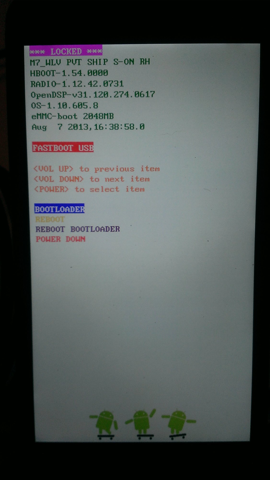

I bought a referb htc one. Completely stock. I turned it on everything worked. than a few days later an ota update came through i down loaded it and now its stuck at verizon logo. How do i get past this ive tried everything.

yes ive tried wipe cache and doing a factory reset in recovery. ive flashed custom roms on my old motorola phones but never an HTC. kinda lost

My HTC one I bought online was completely stock. Its running
hboot 1.54
Radio 1.12.42.0731
Phone is s-on or no super user support its completely stock unrooted. And boot loader is locked.
I did an ota update and its stuck in bootloop now . I tried to use HTC utility wizard but I get an error 171 usb connection fault about half way in. I go into adb and it doesn't show any device. Yes I have latest drivers.
How can I fix this. I'm on Verizon network.
Here r the files
I have a Verizon HTC One, not rooted. The only update I did was yesterday installed Humin app for Contact Management. Today (while it was 85% charged) it got frozen while reading a message on Whatspp. I pressed Power button for a few seconds and it switched off. But now as I start it by holding the power button, it vibrates after 10 secs, shows HTC, and then shutts off after 5 seconds. If I keep holding, keeps going through this loop.
I pressed volume down button and then power button, and get to HBOOT screen with three Android icons. I can use the volume buttons to go up and down on options, but if I choose Recovery, or Factory Reset or even Show Barcode, and then press power button, this screen also gets frozen (i.e. Volume up/Down don't work anymore).
I have to then press power for ten seconds to go black. So in effect I am not even able to Factory Reset the phone.
I tried holding Back and Power, but that goes no where as well.
What can be next option from here?
Thanks in advance for any pointers/help!
