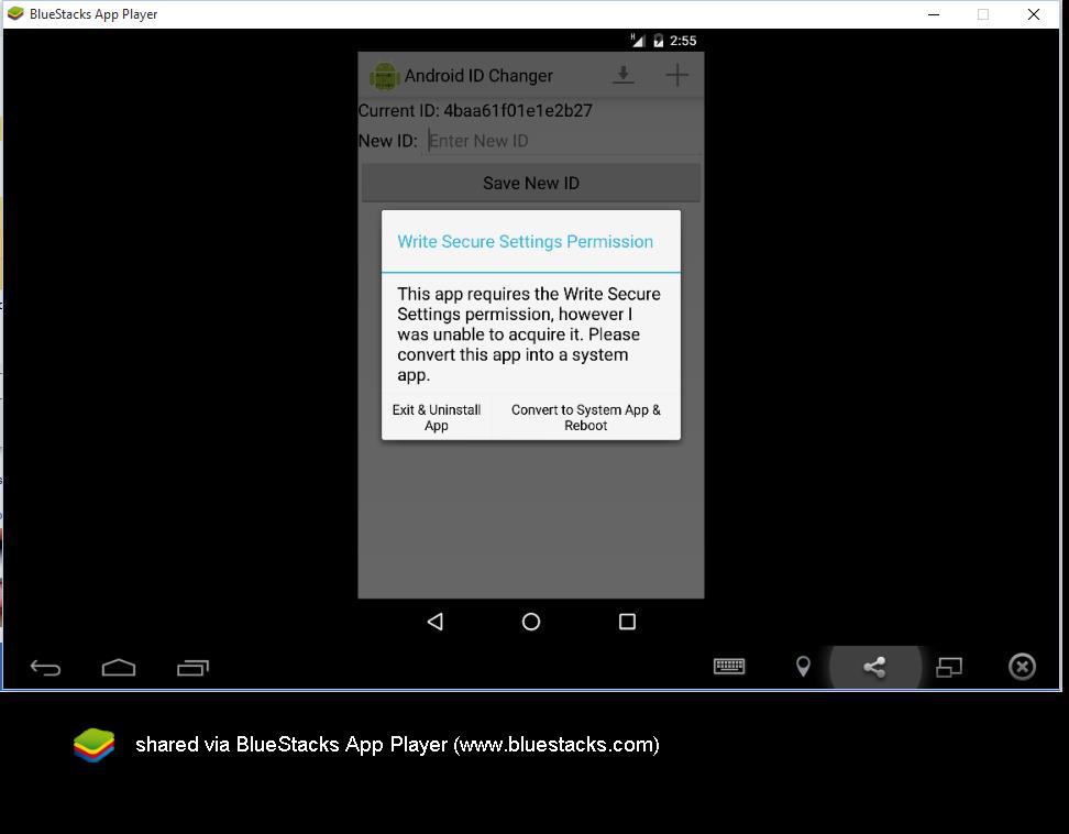

hi sir . can you help me solving write secure settings permission . i rooted my nexus 5 marshmallow . then i installed android id changer . but it’s showing ” this app is showing the write secure settings permission , however i was unable to acquire it . please convert this app into a system app ” . i converted android id changer as system app . but it is still asking like that . please help me solving this . tell me about terminal emulator.
