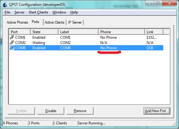

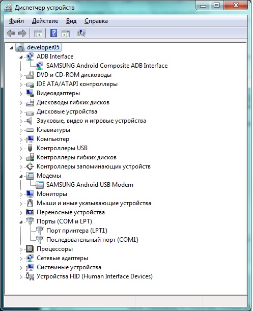

I can not connect my PREVAIL (Build: GINGERBREAD.EJO6) via QPST.
My Prevail is not in ports list (look attach picture #1), i think there should be.
I`he done:
1. Select DM in the Data port menu (##7678# ...)
2. Select USB in the PhoneUtil-DM menu (##8778#...)
3. USB debugging enabled (checked)
4. In the QPST Configuration
a. Ports tab
b. click "Add New Port".... (picture #2)
No Phone :( (picture #3)
PLEASE HELP.

I found the problem.
We had turn off Airplane mode :D
I did not know that in this mode can not see the COM port.
so keep in mind.

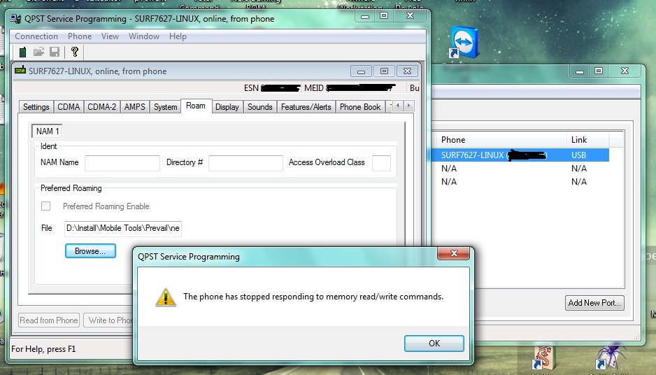

Hi All
Within 20 days can not update PRL. QPST all the time displays a message "The phone has stopped responding to memory read/write commands." (attach #1). Many times repeated, no results.
I have SPC code.
Workshop all the time displays a message "... successfully has been written ...", but in the device does not change. (attach #2).

QPST - there is only one problem: "The phone has stopped responding to memory read/write commands." at write to phone (and read from phone)
Workshop - at the read "Failed to read - Access denied", and at the write PRL successfully, but not working.
After successfully written phone should be automatic reboot ?
