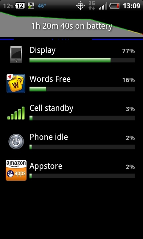

This picture is from 100%, WIFI disabled, 3G and yes I was playing WWF, but the battery consumption is ridiculous. What do you guys think? This is pretty much what happens to me on a daily basis...As an example from 100% I restart the phone and it loses 15%. More, from 100% and 4.2V to 98% and 4.05V in 2 secs.
