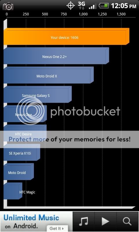

This is basically the first Rom, radio and kernel I've used. After flashing the radio and frankenrom I tried a hydra kernel first, but the GPS was broken so I nandroid'd back and tried kings #3. Everything seems functional so far. After flashing frankenrom and radio (unsure what kernel I was on though) I pushed out a 1499 score in quadrant! The bad news is I absolutely cannot recreate that. Now I get 1200-1300 average. Usually very close to what the nexus one w/2.2 is rated at.

See screenshots for more details:

I ran quadrant and got 1409, then I changed absolutely nothing and now I can't get above 1200. Any clue why?
The big thing for me was the temp. I kept my temp around 69F when doing test.
