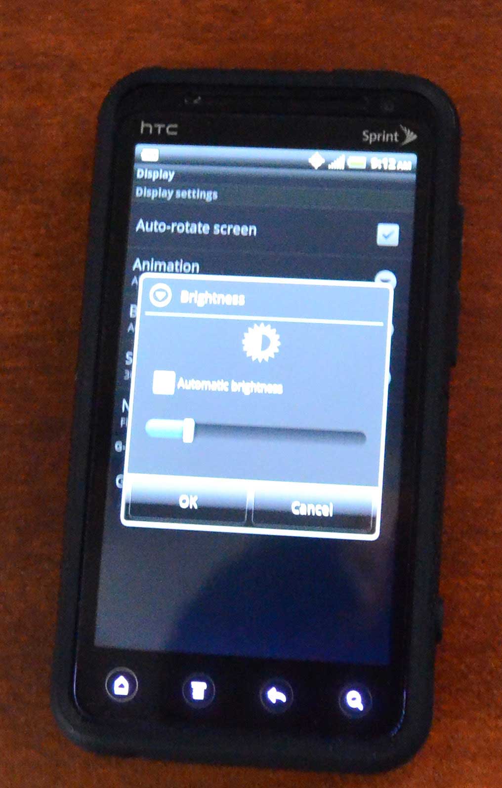

I usually set the display brightness to about 20% or so (for longer battery life).
If I enable the power efficiency now (menu/settings/power/Enable Power efficiency), the display brightness increases to about 40-45% (can't tell exactly because it is a slider).
Given that I'm enabling power efficiency to save battery life, increasing display brightness seems counter productive
Does anyone else have this problem?

I guess my original post wasn't clear (or I missed your point) :)
Usually, I set my brightness slider to about 20% (not auto) - and honestly, unless I am out and about in bright sunlight, I can see the screen perfectly well.
I can understand why the phone would want to set the brightness to 40% or so when I ask it to enable power efficiency - but only if the brightness is already set to higher than 40%.
IMO, the better option (when "enable power efficiency" was checked) would have been to check what the current brightness setting is set to - and if it was greater than 40%, then set it to 40%. But if it was already set to less than 40%, then, don't increase it to 40% (because that will cause the display to use more power than what the user is ok with)
(or am I missing your point?)

nope. two different points. and yours is perfectly valid. the power efficiency system on the phone was not programmed to take into account the user's settings, so it behaves purely in the way it was written to behave, and apparently, screen brightness was hard coded to be 40-45%.
And you are entirely correct that a smarter control system should compare its default value with the user's value and stick with the one that is more energy efficient.
