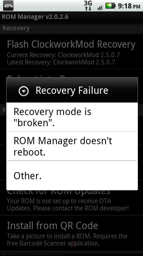

went into bootstrap. hit bootstrap recovery. got a pop up "success!". went into rom manager for the first time after it rebooting and it says in a pop up "recovery failure" then three selections: Recovery mode is "broken". ROM Manager doesn't reboot. and Other. and if by "load recovery you mean "Flash ClockworkMod recovery" i clicked that and selected Droid X. and it shows current recovery: ClockworkMod 2.5.0.7

right i can't even make a backup. Sorry if i was unclear. so i followed your directions to a T. and when i press done it just shuts down. and in my clockworkmod folder the recovery-update.zip was last modified around the time i tried the backup if that means anything.
still didn't work. just took a few seconds longer for it to shut down. This is a ss of what comes up on my ROM manager after opening it for the first time

Same problem here- I also get "An error occurred while attempting to run privileged commands" whenever I click the "Fix Permissions" button.
I rooted using Universal Androot- I've also tried unrooting and rebooting, rerooting- Same problems.
Are all "roots" equal?
EDIT:
Nevermind- Unrooted, rebooted, re-rooted, install BusyBox, Installed Bootstrap, Installed Rom Manager, Run Boostrap, Create Backup-
Success.
