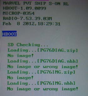

Here is a picture of the screen i managed to catch....

But *** UNLOCKED *** is not there & must be displayed in this above pic...
Have you unlocked & rooted PROPERLY...?
If you are unlocked...
I hope the details in your pic is usually displayed for anybody.
After this, What is displayed on screen..?

Thanks for the suggestions. Finally got it working. I think something must have been corrupt with the original ROM because we tried to flash it back to the stock ROM and it always gave an error message...
So moved on to custom ROM... currently have WildChild v2.0 on it...
