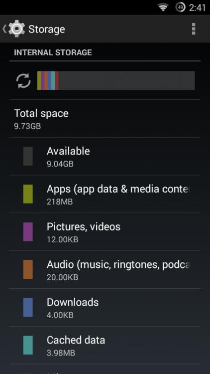

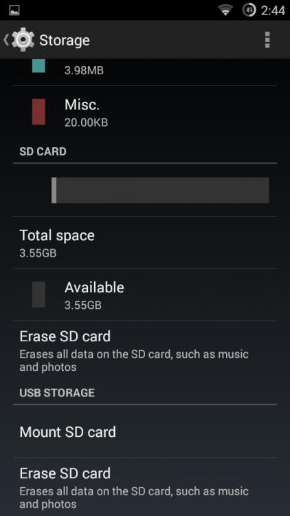

Works on CM 4.4.4 (Hroark13). All buttons etc, same as on KK 4.4.2. I had to use the KitKat SD fix. I hadn't realized that the SD card would be locked like on KK442, I thought with CM it wouldn't be an issue. After installing the fix, upon reboot system A-OK.
screenshots
