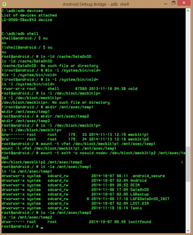

I followed the steps in your post using ADB. The main deviation I noticed is that when I entered "ls -l /system/bin/vold*" it only listed the 87580 entry, not the 13660 or 1220 ones. Please see attached screen capture for all the results (you'll see I made a typo on one command and corrected it a couple lines later). The rest, to my eyes, responded as expected.
Again, thanks for your help.
I'll assume you got no errors after each step. So that means files are installed but the script won't copy your files. My guess is the script can't mount the partition. By the way, the three "exit"s thing: The 1st exits the superuser mode, the 2nd exits adb, and the 3rd (if you typed it) exits Windows' command window.
There's an init_debug.sh script you can try, post #256. Check the post to see if it helps you solve the problem. If you need further assistance, let me know where you get stuck.
You can also debug it manually, since you have adb. Start with "su" to get a "#" prompt. In the following, text following the "#" prompt is command and expected output follows that.
Check the absence of the temporary directory:
Code:
shell@android:/ # ls -ld /cache/DataOnSD
/cache/DataOnSD: No such file or directory
If the script has aborted, you might get this instead:
Code:
drwxrwxrwx root     root              2014-11-07 17:20 DataOnSD
If so, clean up:
Code:
shell@android:/ # rmdir /cache/DataOnSD/vfat
shell@android:/ # rmdir /cache/DataOnSD/ext4
If you get any "No such file or directory" message, don't worry about it. If a command returns some other message you can't figure out, let me know.
Check installed files:
Code:
shell@android:/ # ls -l /system/bin/vold*
-rwxr-xr-x root     shell       13660 2014-09-07 04:07 vold
-rwxr-xr-x root     shell       87580 2014-03-24 05:21 vold-original
shell@android:/ # ls -l /system/etc/DataOnSD
-rwx------ root     root         1220 2014-09-11 15:42 vold
Check partitions exist:
Code:
shell@android:/ # ls -l /dev/block/mmcblk1p*
brw------- root     root     179,  33 2014-11-07 16:45 mmcblk1p1
brw------- root     root     179,  34 2014-11-07 16:45 mmcblk1p2
Make temporary directories:
Code:
shell@android:/ # mkdir /mnt/asec/temp1
shell@android:/ # mkdir /mnt/asec/temp2
Try to mount partitions:
Code:
shell@android:/ # mount -t vfat /dev/block/mmcblk1p1 /mnt/asec/temp1
shell@android:/ # mount -t ext4 -o nosuid,nodev /dev/block/mmcblk1p2 /mnt/asec/temp2
If the commands return any error message, something's not right. Otherwise, check partition contents:
Code:
shell@android:/ # ls -la /mnt/asec/temp1
<... DIRECTORY LISTING OF YOUR FAT32 PARTITION ...>
shell@android:/ # ls -la /mnt/asec/temp2
<... DIRECTORY LISTING OF YOUR EXT4 PARTITION ...>
Directory listing of the fat32 partition should show an empty file "LGF6DataOnSD_INIT" if the script never got to deleting it.
If everything looks okay, reboot and see if it works. If something doesn't look right, let me know what you get.
Good luck.
So that means the binary file was not installed. I notice you did "ls -l /dev/block/mmcblk1p*" twice. The first time it didn't work but the second was fine. Weird. Anyway, since it looks like your partitions can be mounted, they are okay. So let's figure out why your installation has failed.
As before, go into "adb shell" and get a superuser prompt with "su". In your case, your prompt shows "root@android:/ # " whereas mine is "shell@android:/ # ". That doesn't matter, as long as you get a "#". The commands to install:
Code:
cd /storage/external_SD/
touch LGF6DataOnSD_INIT
cd DataOnSD
sh installer.sh both
The corresponding output:
Code:
shell@android:/ # cd /storage/external_SD/
shell@android:/storage/external_SD # touch LGF6DataOnSD_INIT
shell@android:/storage/external_SD # cd DataOnSD
shell@android:/storage/external_SD/DataOnSD # sh installer.sh both
Making /system writable ...
Installing executable to /system/bin ...
Installing script to /system/etc/DataOnSD ...
Making /system read-only ...
Reboot to apply changes.
Notice when a command fails, you get a number in front of the next prompt like "1|root@android:/ # ". After these steps are done correctly, normally you exit and reboot. But let's check the installation again:
Code:
ls -l /storage/external_SD/LGF6DataOnSD*
Expected output:
Code:
shell@android:/storage/external_SD/DataOnSD # ls -l /system/bin/vold*
-rwxr-xr-x root     shell       13660 2014-11-13 12:17 vold
-rwx------ root     root         1220 2014-11-13 12:17 vold
shell@android:/ # ls -l /storage/external_SD/LGF6DataOnSD*
-rwxrwxr-x system   sdcard_rw        0 2014-11-13 12:17 LGF6DataOnSD_INIT
Type "exit" twice to exit the adb shell. If everything looks right, reboot to apply changes and hope it works this time. Let me know what happens. Good luck.
Good news! I followed your instructions and it worked exactly as you said. Played around with it a bit last night, and gave it to my daughter to use today. It did sporadically crash on me last night, not sure why, I couldn't find a pattern to it. The initial boot after following your instructions was very lengthy and it started to boot loop so I had to shut it down after about 15-20 minutes of waiting to see if it was going to resolve itself. After that it booted up properly and appeared to work correctly. I'll keep my eye on it.
BTW, the command that I entered twice above, where it didn't work the first time but did the second time was because I mistook the "1" for a lower-case "l" the first time. I realized it after a bit and re-entered it correctly.
Again, I really appreciate the help.
