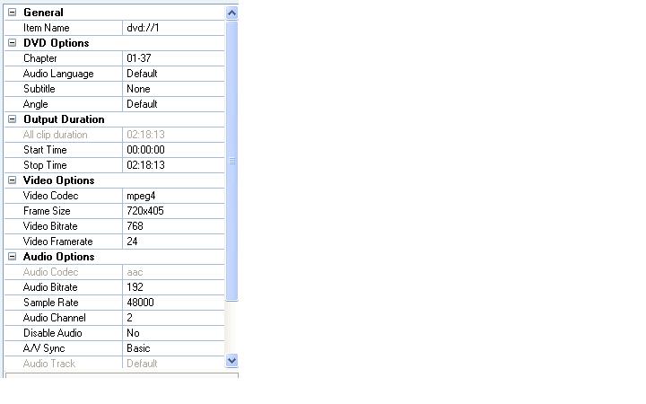

Any way i convert videos the end result is great video and audio quality, but i am having out of sync issues. The audio is late. Sometimes i can restart the device, play the same video again and it works fine. What conversion setting helps to fix this if any? I am mainly ripping my own DVDs. See attached screen shot for my settings.
Thanks!
