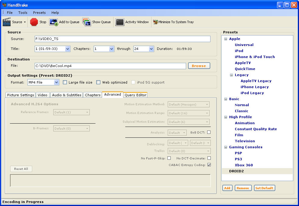

So, after many hours of playing, I have come up with the best settings for ripping my DVDs. I have tried using Any DVD Convertor Professional with no success. The videos come out good, but any movement, fast forward or rewind, causes audio to go out of sync.
Here is what i have determined to come up with a good video quality, synced sound except on rewind but can be fixed on fast forward. Make sure you are using Handbrake (0.9.3 Build 2008112300) and DVD43 (4.6.0.0) for decryption.
See attached screenshots. The resulting video file is roughly 400-600MB in size depending on length. On a Dual Centrino with 4GB of RAM it takes roughly 25-45 minutes per DVD.
FYI. I am a novice when it comes to video conversion. So if someone does not agree with these settings, too bad. It works great for me.
