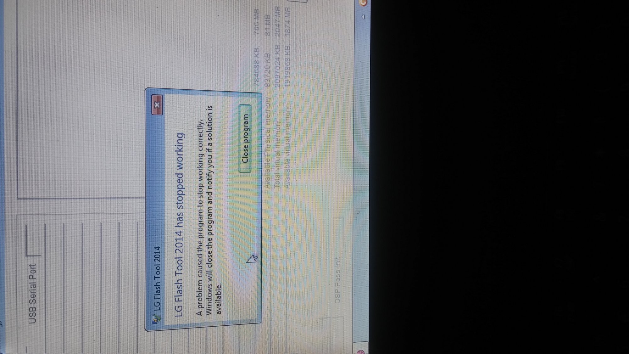

Can someone repost the link for the recovery firmware for h631 5.1.1. Androdfile download seems to not be a working option to get the flashable drive for my tmobile device. I bought my lg stylo last weekend and have a problem with getting a successful root. Can you also send instructions on how to root step by step. Im sorta new to this and dont want to brick my phone.. Someone help..
So the root tool keep clsoing out before root os completed.. I have no idea whats wrong.. I had hope until thos keeps happening.
Thats a screenshot of whats happening. Can you help me please.

So im clearly doing something wrong when doing this step.. So is there a how forum where i can root,install the firmware, etc step by step ..im fimilar with rooting just need exact instructions..pretty android savvy. Its just been a long while since ive done this and ways have changed.. So if you can bare with me .. What do i need to do..

did you already update to 5.1.1 10i?

I've already linked you to the guides we're all using which are pretty easy to follow...
Go here and follow the guide to flash the new v10i kdz update:
http://androidforums.com/threads/guides-root-update-firmware-unbrick.922186/
After updating to v10i then go here and follow the root guide:
http://androidforums.com/threads/guide-how-to-root-us-lg-g-stylo-on-5-1-1.937446/

So hey the first set of guidelines. Thats were o keep getting timeout at with message about . what does ot keep telling me the the root tool has stopped running after i start cse flash.

I dont see anything next to 5.1.1. and nothing under the software woth those varibles. I bought it this way and i havent received any udate ota. I dont think. Ive had it about 5 days now.
Can you go on your phone to "settings/About phone/Software info" and post exactly what it says under "Software version". Or you can just post a screenshot of that screen.
