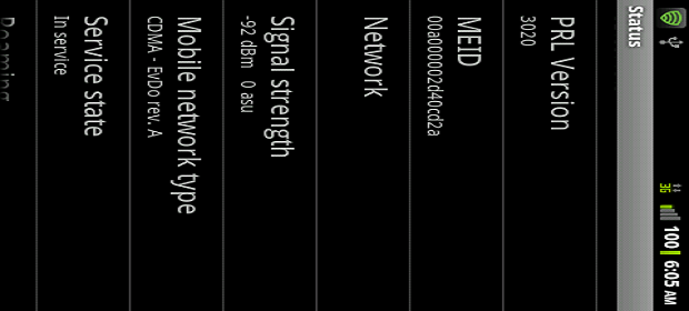

You my friend are the shiznit! Im watching it in the settings and I have PRL 3020 I have 1x right now but I saw it switch to 3G! (Just must not be in a good area) But it works!
Edit- Since 1x still works this means this PRL will work with 1x and 3G. So even if you dont have 3G in your area you will still be good to go. You'll just be ahead of the game. I was in the settings when it switched to 3G and watched it go from CDMA 1xRTT to EVDO and then switch back.
