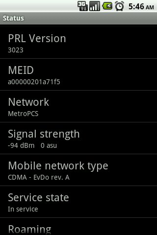

I've had prl 3020 and 3g since july. I dialed *228 and it went back to 3019. I went back to stock for awhile and keep doing *228 it kept saying it failed. I looked earlier I had 3g again and now prl 3023.
Here is your screenshot
