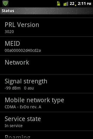

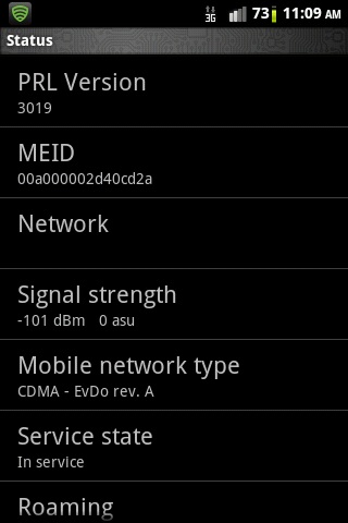

On a different note. Went to the other side of town today and I had 3g with the 3019 prl! Then bout an hour later I still had 3g and I went to see what my prl was and it switched to 3020 all on its own!
SO my PRL is STILL 3020. Changed all on its own and now my data didnt work again because of it. So I had to call *228 and change it back. I dont know why it changed since I didnt update the roaming list and I had 3g signal while one 3019!

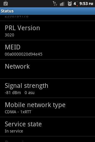

Was finally able to get prl 3020 on my phone by doing a backup then flashing pg's 2.2, went through the steps then restored my backup. Used the *#*#4636#*#* tip to switch it to edvo only and turned the radio off and on a few times. 3G did actually come up a few times but failed the ping test. I was driving at the time so maybe if I find a stationary location with a good signal I'll have better luck.
3G WORKS GREAT! i did the 3020 update but a guy at work has a stock ascend and it switched on its own yesterday as well. so if your in a 3g spot it should switch on its own
