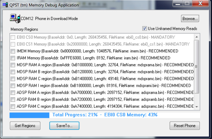

    4. Exit out of QPST Configuration and Run QPST -> "Memory Debug App"
    5. Click "Browse", choose the COM port, click ok and the Icon on the top left should state "COM # Phone in Download mode"
    6. Tick "Use Unframed Memory Reads" (see img below) then press "Get Regions".
    7. To save space, deselect all, select a "SaveTo" Directory. When done you should now have a ebi0_cs0.bin file in the folder. In process you should see the following screen.
  3. Install HxD Hexedit and open your bin with a hex editor
    1. Open Hxd Hex Editor from the start menu (location is "<Your Program Files install Directory>\HxD\HxD.exe" )then drag the file "ebi0_cs0.bin" your self-selected SaveTo directory to the program.
      Note!!f If ebi0_cs0.bin is nothing more than 0s and/or fs then your file is corrupt / unfinished. If your file doesn't look empty and contains data, zip ONLY ebi_cs0.bin. The file size of the zip file should NOT be less than 20mb.

Same here, there was no unframed memory read option. But, I went ahead and did it anyways, then when I pulled it up in the Hex reader the only things that were in the bin file were 0,F,., and weird y's.
Worked well up until "Use Unframed Memory Reads"
I'm not seeing this anywhere...
First, did you flash to a different rom?
Second, try downloading this version. http://conflipper.com/Software/QPST_2.7_366.rar
it's a check box on the screen before get regions. Does your window look like the attached jpg??
Third, this option must be available and ticked or else will give an error.
Lastly if it borks out try leaving all bins selected in step 10. It takes longer but perhaps it works better. For my phone it was the same either way. I deselected it as it was faster and took less space.
IIRC you reflashed your rom right? If so then you are not using the default firmware and therefore would be using a different bin from us.
However if you are using the default firmware, then feel free to zip up the file then upload to mediafire or 4share.

Well I tried with qpst 2.7 366 and I did get the unframed memory option however same results. All y's. Searched for an hour to no avail.

Good news!
- I re-installed the USB driver for Windows from LG.
- I checked all boxes on the phone in Settings -> Applications -> Development (the first time I only had USB debugging checked)
- I ran QPST Configuration, QPST Memory Debug App as Administrator
- This time I unchecked all the regions (which I was able to uncheck) in QPST Memory Debug App, so it only saved the MANDATORY ones (the first time I left them all checked)
- The ebi0_cs0.bin, ebi0_cs1.bin, and load.cmm files came out the same exact size as my first attempt. However, for whatever reason, the content of ebi0_cs0.bin was much different.
- This time the MSL was located exactly at hex offset 07496A80.
I'm not sure what made the difference.
Thank you for the help, WhisperPntr.

I have a question. Why won't qpst or the memory debug app work for me if I run it as administrator? Everytime I run it , it will not show any com/ports but if I just run it normal it shows my phone and appears to work except all I see is yyyyyyyyy.....
I've never had that issue dobs. likely a bug with the program though run qpst configuration as administrator too. It needs to detect the com port and if it doesn't then it's a LG driver or software related issue
Heyy guys. I need help. Mine is giving me an error and saying that the port may be busy or not working properly, any helpp?
First what step are you on? Did you start in emergency/download mode? I made a correction to the guide as the phone must be in download mode to register a com port.
Did you look up in the control panel -> Device manager to make sure that you see a Ports > LGE Android Platform USB Serial Port > Properties > Port Settings > Advanced > COM port number ?
Also go to QPST Configuration and select the port on the left hand side list then click add new port.
Yeah, Im to the point where Im adding the new port. But for some reason it shows it as a LGE AndroidNet USB Serial Port. It will show up in QPST as the correct COM# which happens to be 10. It just says its busy and/or not working properly.
I also have the same build, kernal, and version as you do.
