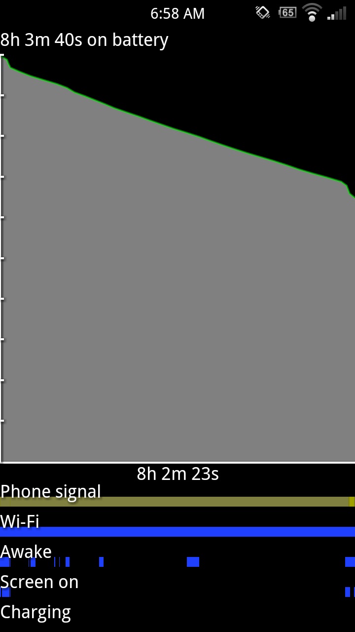

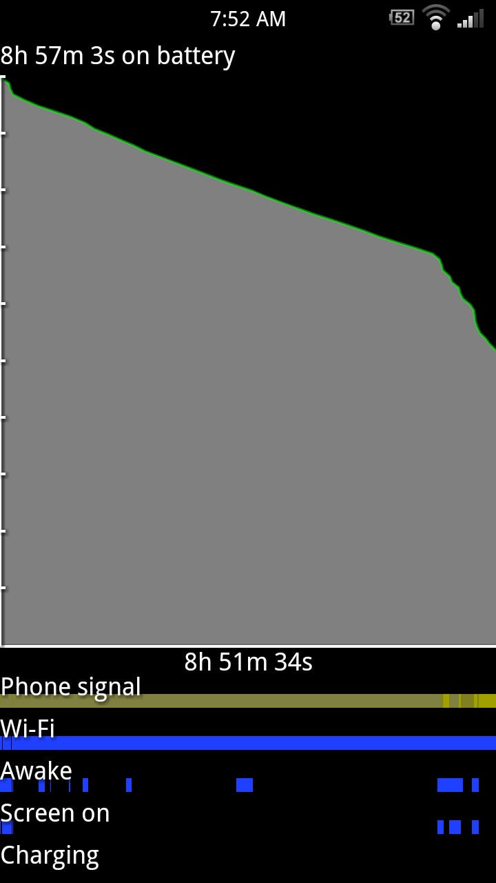

Hi all,
I'm bringing this over from the BP thread since its really not BP related anymore. MrB206, BlueRacer90 and mickeydurden have been great help so far and I'm happy to see them here, as well.
Backstory:
I flashed BP with Plague kernel and experienced serious battery drain. So I flashed Broken Out 3.0 and it is a lot more conservative but could be more so, I think. I have given Location access to very few apps, I manually adjust my screen brightness, Most apps are not constantly refreshing in the background. I'm underclocked using smartassV2 and deadline IO. I'm not streaming videos or music (my a-Pad is for that) but I do browse quite often and have a few games that I play but not often. I use wifi whenever possible, but that seems to have a small issue, too.
Yesterday evening I had to charge up and then let it sit all night unplugged just to see what I got (screenshot 1). A little while later, the battery had dropped again (screenshot 2).
Issues:
Battery life could be better from what I've been reading in the threads. What else can I do?
Screenshot 1:

Screenshot 2:
Wifi has also been spotty, I can be right in front of my router and still get timeouts. I have the main wifi in my office in the basement and a range extender on the first floor so there is a solid signal throughout the house. I can be right in front of either with my phone and still not get a steady full signal. My tablet gets full or almost full throughout the house. Is there a wifi update that I am missing?
-bzr
See, screenshot 1 is odd unto itself. With wifi and no use, that should be more flat.
Now, I find running ANY rom on this device at 1.512 to harm it, so I scale my cpu back to 1.296. For BO, I use the gaumaufry (sp?) governor and I had a far flatter line than you. Stay away from on demand... It spikes you cpu to max when ever its 'called', so battery drain is noticeable.

I saw this link being posted somewhere else and thought it might be helpful to you to learn about the different govs and IO's:
http://forum.xda-developers.com/showthread.php?t=1369817
Are you using no frills cpu to set all this stuff? I prefer it in BO3 over Rom toolbox even though I have used both in that past.
We could be overlooking the obvious here too; maybe you happened to get a bad battery with your phone. You don't happen to have any spares you could try, do you? Honestly based on everything you've described, you should be getting decent battery life, unless there's some app you have that just kills it for some reason, or if you're streaming lots of videos on your browser. A new battery might do the trick.
