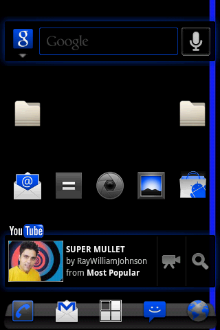

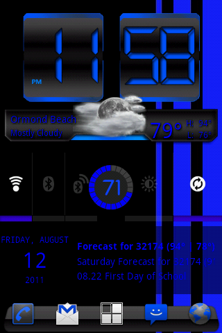

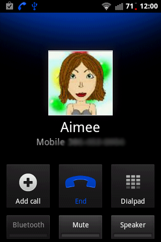

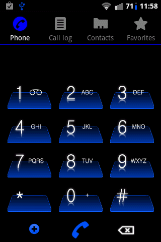

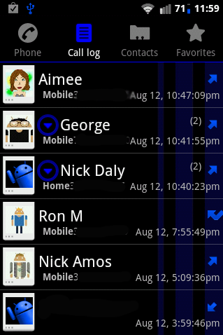

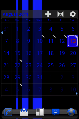

heres some screenies for ya..
Just curious, how did you get it to be fully themed? for example on the dialer, how did you make the digits blue and all the arrows blue in the call log? I tried to install themes through the theme chooser and it only skins half the things that are supposed to be....
glad to see you got it working. in the future, if you only have one app failing to work and FC'ing on you, it's worth it to just try to reinstall that app. If it's a system app, just see if you can get an update for it. I remember when I first rooted the old way by downgrading to 2.2, when I downgraded and rebooted, Gmail was FC'ing on me. I took my friend's suggestion and installed it off the market again (I guess there was an update available?). Worked fine.
yeah when i flashed teh gapps.zip and rebooted the gmail app wasnt on my phone anymore.. had to download from market and it fced everytime it tryied to update and everytime i tried to open it.. uninstalled it and re-installed it and same thing.. that why i tryed to do the restore and etc.. int he end though was worth it.. now its just the low volume thing.. but everything else is perfect
I used the Blue Bionic theme from upwardspiral on the market. if you follow the link to the developers website on the market you will find a listing on xda with links to the extra theming. u will need metamorph from the market and there are 3 addition zip files u need to download to get everything themed and flash them with metamorph. they are as follows for the blue:
BlueBionicBasicMdpi.zip
BlueBionicAddonMdpi.zip and
xtremeDialerMdpiBlue.zip all available from devs website.
