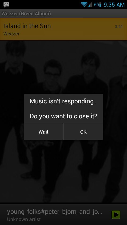

Edit: Find out the Google music player doesn't work it doesn't play the song
I just tested Play Music and it isn't working for me either. I don't get an error, it just doesn't play...
Hmm...play music is working for me. However, when u try to play a song with the stock music app, it just hangs on a black screen indefinitely.
EDIT: So just tried the stock app again and it worked flawlessly. Something fishy going on here Batman...
I posted a while back about this. It doesn't matter what app you use to play a song, it will hang and fail the first time. After you force close whatever app you tried to play the song with, it will work fine for all apps. Until a reboot.
Only seems to affect MP3s.

G60, your work is quality. The only thing issue I had so far is with MP3 playback, like a lot of other people appear to be having. Seems to be a low-level issue, since I personally have experienced it in both the stock music app as well as Google Music. Stuff that's pulled off the internet works fine all the time. Other then that; this ROM is stable.
