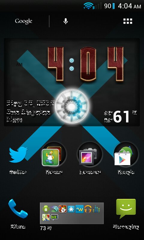

Been seeing this happen often now, love this rom but it's really a pain to read this XD. All jokes aside anyone else have this issue or is there a fix?

Yes, I sometimes have the messed up fonts. It's a known issue. Apparently the current version isn't as bad as the previous version: Are you running the current version?
It took many days for the fonts to start messing up for me, and since then it seems like it happens more and more over time: I wonder if it is a cumulative issue, like something that gets worse as your memory space goes down, or something like that.
I am still looking in to it, my first two hunches didn't pan out, it is a lil harder to track down than I first thought. I am gonna have to start from scratch and add things one at a time to figure out what is going on. But, do the math, I changed hundreds of things and it takes anywhere from 10 minutes(rebuild with out cleaning, which sometimes carries over things from the previous build) to 45 minutes or so to build fresh.
