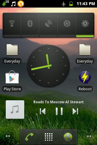

- Would like option to install stock clock widget. (black and green one, attached)
