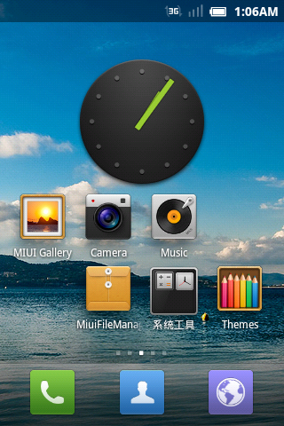

I think I have a lock screen work around. Download Milocker from the market, it should work just fine. Gonna test it out now
Tested and working. Some lock resolutions are generally bigger though so all may not fit to the screen but the majority do
