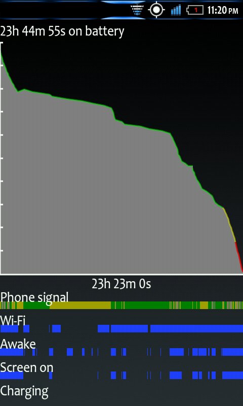

Nothing wrong with this rom i just got my extended battery and this will say it all yes phone been all since 12am sat to now 12am sunday
