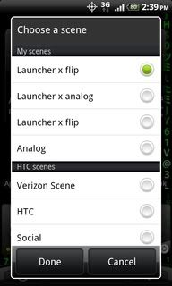

I dont know if this is a bug or what... but I was finally fine tuning my scenes and I noticed it didn't tell me "would you like to replace this scene of the same name" not I have 2 with the same name... is there any way to delete the duplicate.. I tried long pressing the scene and nothing happens...
edit: I fouind out how to remove them... you can't do it from the popup menu scene... you need to go to settings>personalize>scenes and long press to delete them
edit 2: now i'm going crazy.. I just moved a few things saved it again and it asked me if I would like to replace it... you see the screenshot I'm not lying lol.. weird
