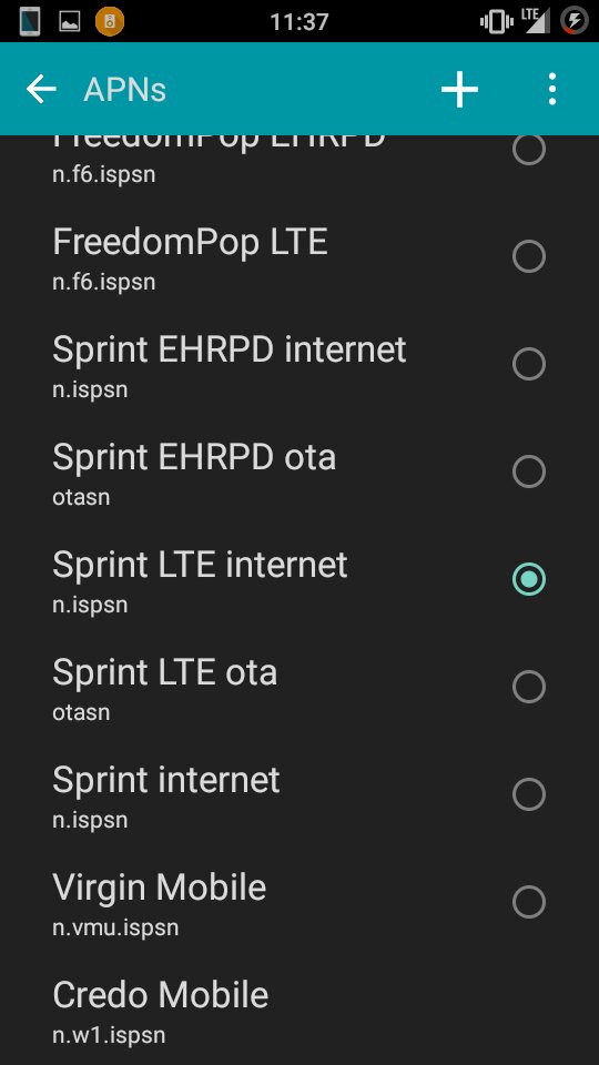

This works... But 8SMS needs to be downloaded and configured to send SMS/mms
BTW that's without Boost/Virgin APN Fix being flashed.
the boost APN in the list works fine.. But only with 3g
