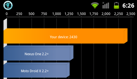

I can confirm wifi is working and the keymapping is correct now. However, I wasn't able to get the GPS to lock onto any satellites.
Also, in case anyone is wondering- I got a 2430 quadrant benchmark score using cm7 :)
Thank you... that is impressive
Just wait til we get that kernel source and crank our speed up to 1.4 or 1.5 GHz. :)
Out of curiosity, I ran a benchmark on the stock ROM and pulled about 1730. So, 2430 is an impressive increase.
Stock just produced a Quadrant of 1898 for me, 2428 for the alpha CM7.1!
