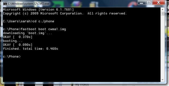

I'm stuck as well, i backed up my. Laf partition and nuked it and can boot into fastboot on my android and i thought i had adb and fastboot setup correctly on my win 7 pc but now a. I am unsure where to put both cwma1.img on my phone and also i am unsure of where to place the v4 update so it can be found. I stayed up until 2 am and when i enter fastboot devices to see if my phone is recognized the shell lists out a series of maybe 10 or 12 numbers with a space and then fastboot... If i try to boot the cwma1.img using the command given, the output says device not found. My phone is really messed up so i am trying to decide if i want to break the phone, pc or both today lol :D
I tried uploading a mirror while I slept but it failed. I'll try again. As for where to put cwma1.img, I think in windows your default folder would be your user folder, you can put it in there or you can change directory (CD) into wherever it's located, ie, a download folder. The zip goes in the root of your SD card.
Can you take a screen shot of this? Are you using fastboot from the adk? Or are you using easy adb?
Im using the minimal adb and fastboot on my laptop but i have the version from the adk on my desktop, my wife was sleeping last night so i had to use the laptop. How can i take a screenshot of the fastboot on my phone? I boot into it using the method yet but i have no figured out a way to enter any commands in that mode yet if i tried to take a screenshot I would have to hit the power button and that would reboot my phone.. I used terminal emulator from inside android to enter the commands you suggested, the output from the second command said i didn't have enough space on my phone but i still have plenty
I meant a screenshot of your desktop after entering the fastboot commands.
This may be noob question but do i have adb shell on my pc running at the same time as my android running fastboot? Or do i run the command to boot into cwm from my pc first using fastboot boot cwma1.img and then my phone will boot into cwm from there? I have a brain injury so im kind of confused sometimes. Thank you for your help, i know i can get this right
Your phone has to be in fastboot mode, it'll be a black screen with a bunch of white lines of text. Fastboot is a tool you use from your PC, you open it up from cmd not adb shell. I can possibly remotely connect to your PC with team viewer and show you how to do it.

I got it to work. here is a screenshot of fastboot on my pc. I was so happy to see cwm again! Started fresh and flashed the superuser zip you posted too. I followed your directions exactly, also I put my adb and fastboot folder in my user directory on windows, and created a folder called "phone" in my c: drive and placed cwma1.img in there so I could cd to it without confusing the path... I got my adb and fastboot stuff here from xda. [TOOL] [WINDOWS] ADB, Fastboot and Drivers -… | Android | XDA Forums Thanks a million donjuro for walking me thru it! :) now to debloat a little. I'll let you know how it's working.
