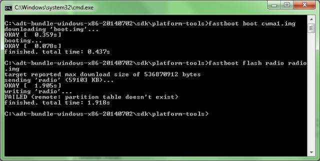

I can update my PRL & profile...at least it says it went fine. Not sure how to tell if it actually did anything if there wasn't anything to update.
Just tried flashing the radio with fastboot and it failed...
