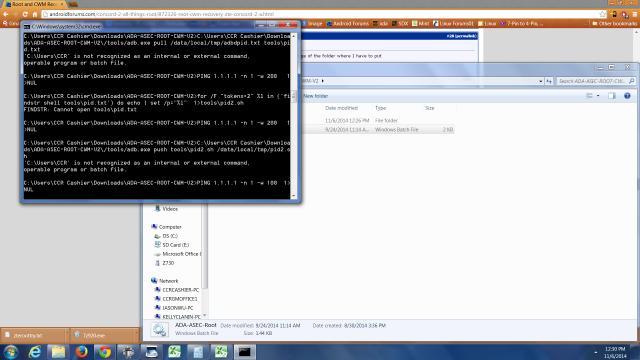

Hi guys, having an issue and need help please. When I run the batch file, it runs quickly, closes and does nothing. The batch file is moved to desktop with no spaces in the name
the problem is you folder names have spaces in them
move the folder to the root of c: and take spaces out of folder name
