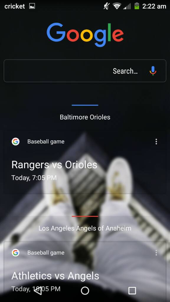

Real quick cause its late i tried rro layers manager and have successfully installed a layer the first time around I got a system ui has stopped so I restored my phone tried again and didnt check theme system ui and it worked here are 2 screen shots one of the google app and one of settings themed using neat friends layers theme, dont have time to full around much more with it tonight but it does offer us new options with out a custom rom, as always back ur phone up before trying this and u must be on lollipop

Quick update system ui works it must have been an xposed module or an incompatible theme but for those who like to theme your phone this opens up all new possibilities enjoy

The only xposed modules i stopped using were xstana and xblast, I still use gravity box. There are some elements of our ui that do not get themed ie. all the zte bull crap like the quick settings and signal bars in the status bar. Most layers themes have worked for me only like 2 have caused boot looos. Honestly trial and error is how i find what i like but if you encounter a boot loop the only way I have found to get out of it is to restore a nandroid back up

If you get a bootloop using layers, just boot into twrp recovery, mount system, go to the file manager in twrp (found under the advanced tab), delete the /system/vendor/overlay folder, and then reboot. This removes all the installed overlays without having to restore a nandroid. It is quicker and better than restoring a nandroid
