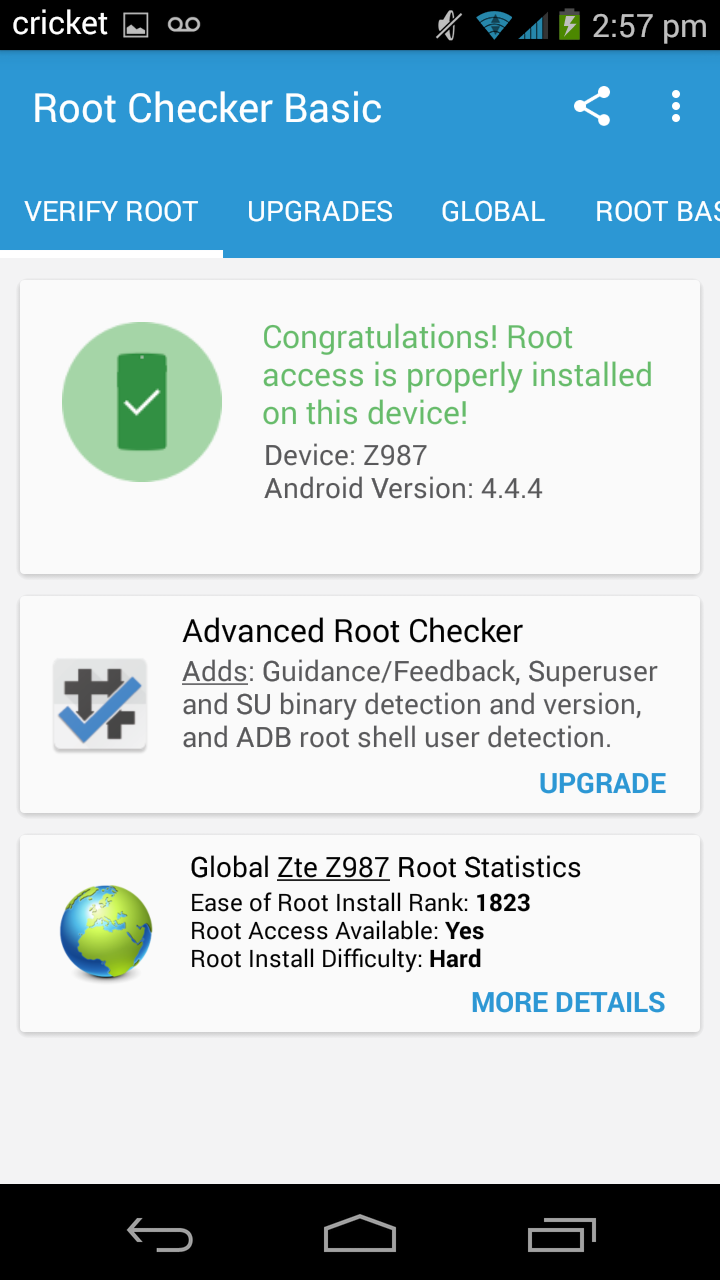

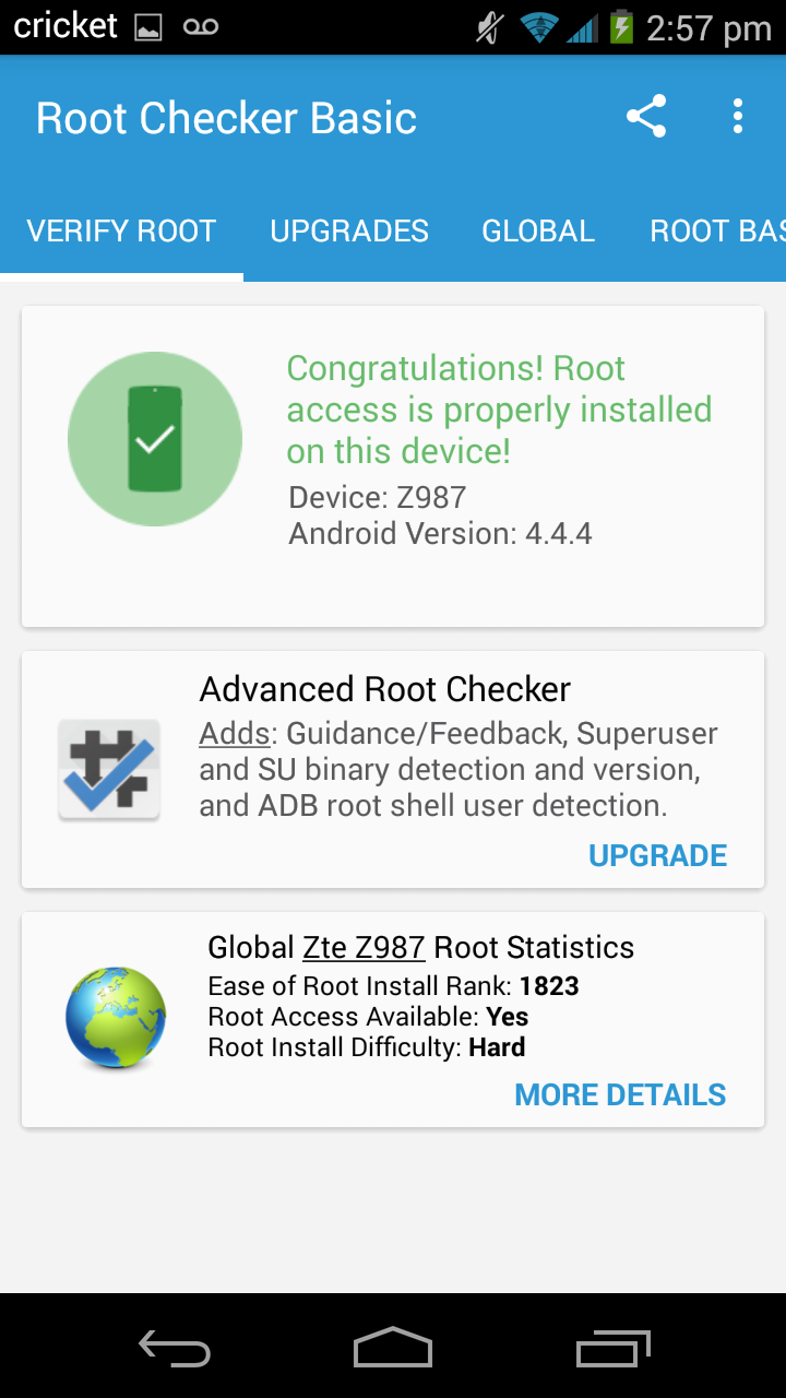

Can confirm that this works on the Grand X Max + on Cricket Wireless!
Went through the above process, ran SRSRoot, Then Kingo ROOT.
Root can now be verified by ADB Shell and through Various other Root Checking applications.

I confirmed that it worked by using adb shell command su. Verified that I had root access that way. Then I went through the above mentioned steps. Installed the latest version of two for ZTE and now I'm rocking KitKat as we speak.
I confirmed that it worked by using adb shell command su. Verified that I had root access that way. Then I went through the above mentioned steps. Installed the latest version of twrp for ZTE and now I'm rocking KitKat as we speak.

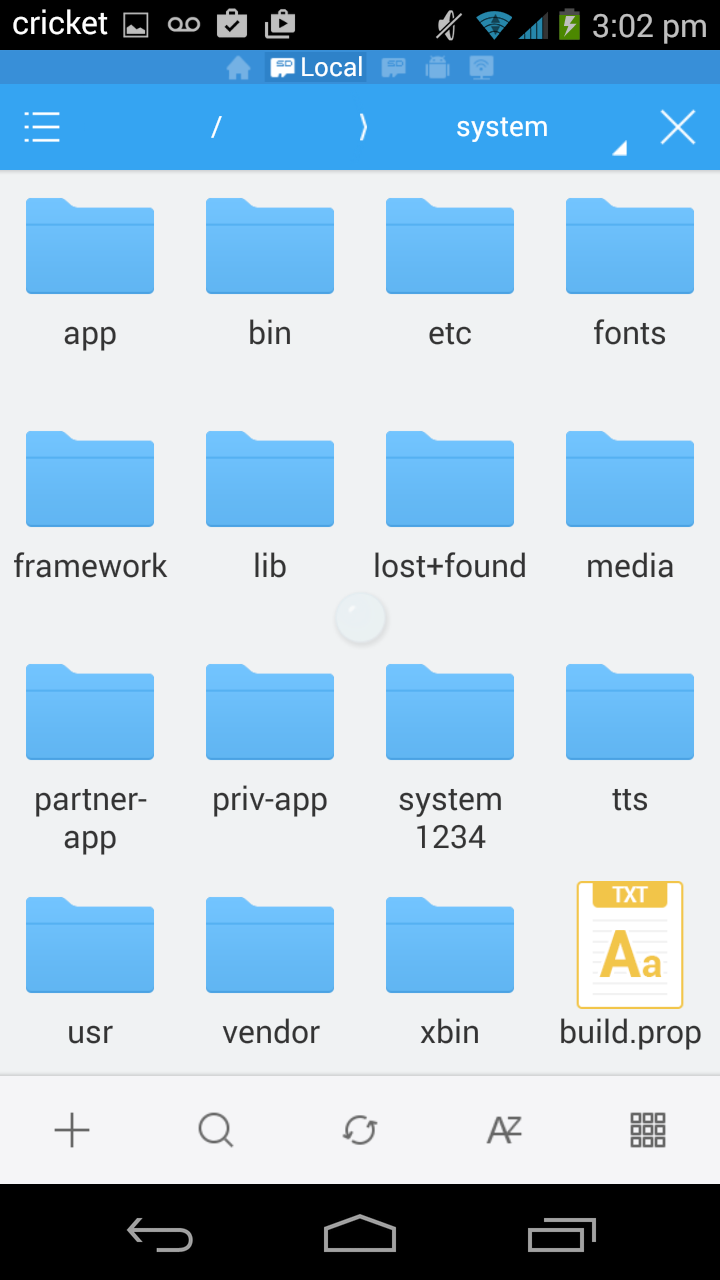

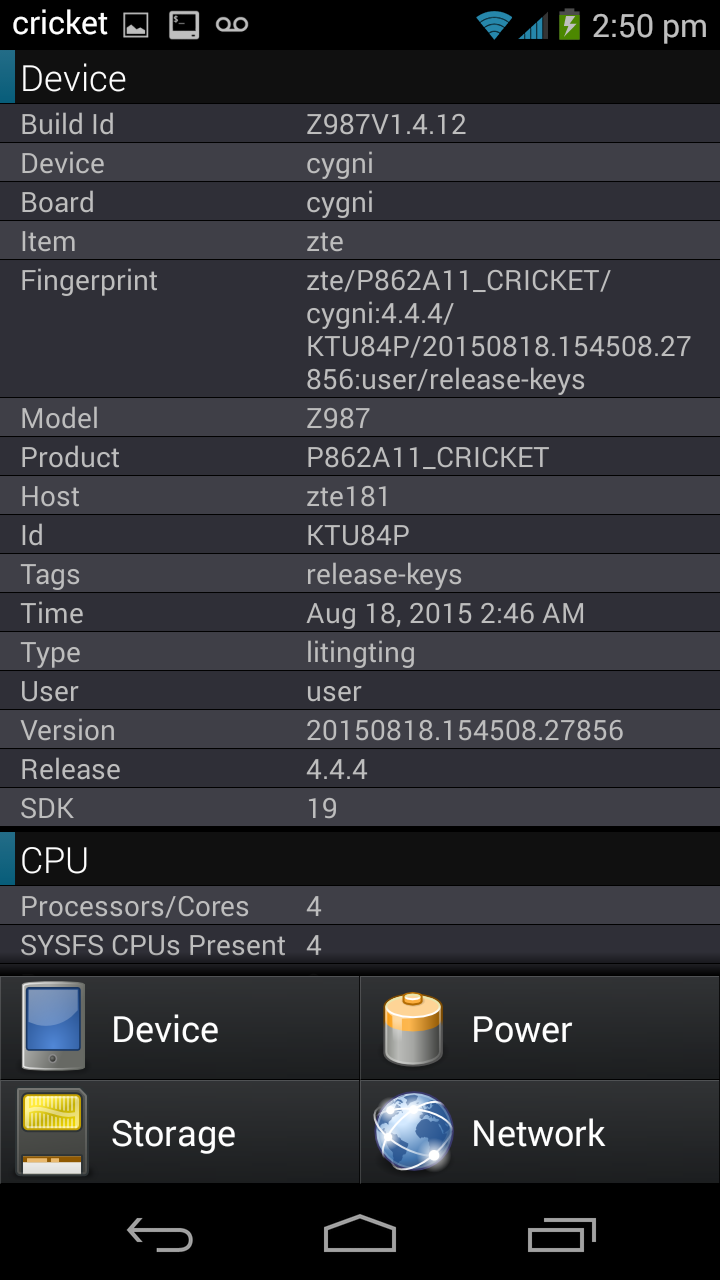

OK, right now I'm not on the PC but I can tell you that I am on 4.4 right now.

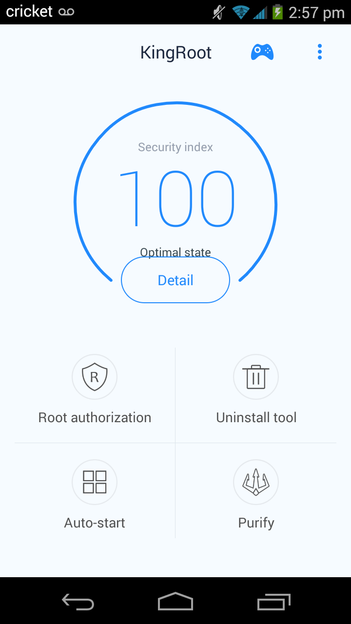

1st ran Newest Kingroot
2nd used a terminal emulator and ran "reboot disemmcwp".

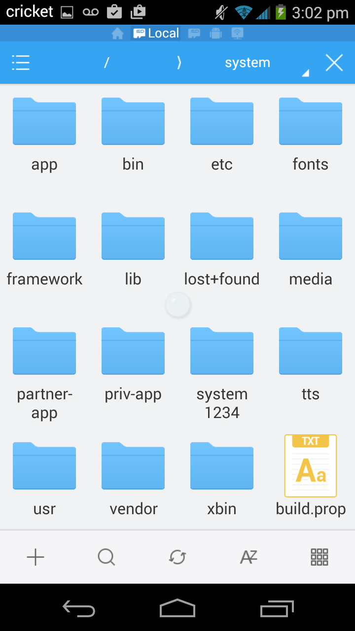

3rd Created folder named 1234 in system folder, and created a dummy .zip file.
4th Rebooted
5th Checked to make absolutely sure that the folder and dummy file was still there. It was.
I can install Lollipop to verify that this same process works, tomorrow.
Also, I was able to uninstall bloatware once I ran the reboot disemmcwp command. Before that it would fail to uninstall with a force close of the app.
4th Rebooted

Did I do it right? Am I fully rooted? with rw. ?
Which one? I ran the first one. Reboot disemmcwp. My phone rebooted then I created system file 1234 .then ran second one .emmcwpenab
my phone rebooted again
The command to give you r/w access to the system is "reboot disemmcwp"
The command to revoke r/w access to the system is "reboot emmewpenab"
There isn't any reason to run "reboot emmewpenab" because, well, you WANT to have r/w permissions in order to have full root access.
