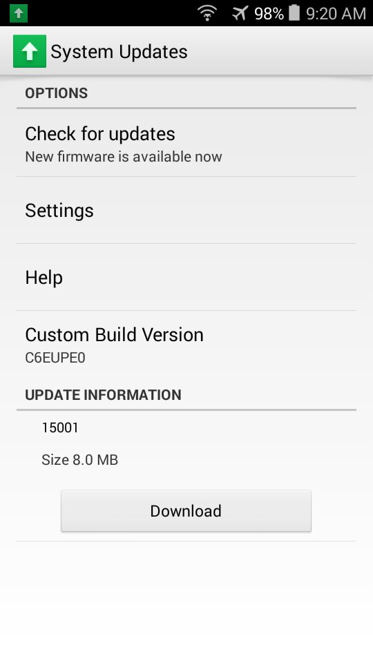

Has anyone installed this update? What is new?

Have you tried to reset the phone, since it might be the only way to restore functions on the phone, but losing anything on the internal memory (unless you have backed everything up on the External SD Card, in which it won't delete anything from the card.
Ok so we got to work around it.
Unroot the phone first.
then download the ota but dont install it.
Next root the phone again
then use ota snatcher to pull the download off the phone.
Or use root browser.
Make sure it is set to show hidden files and folders.
The update should be in a folder called
.download
Notice the .
That makes the folder hidden.
DO NOT ATTEMPT TO INSTALL THE OTA When ROOTED.
IT WILL WILL WILL brick you forever.
Just get me that OTA and I will make you a flashable update that won't brick the phone.
