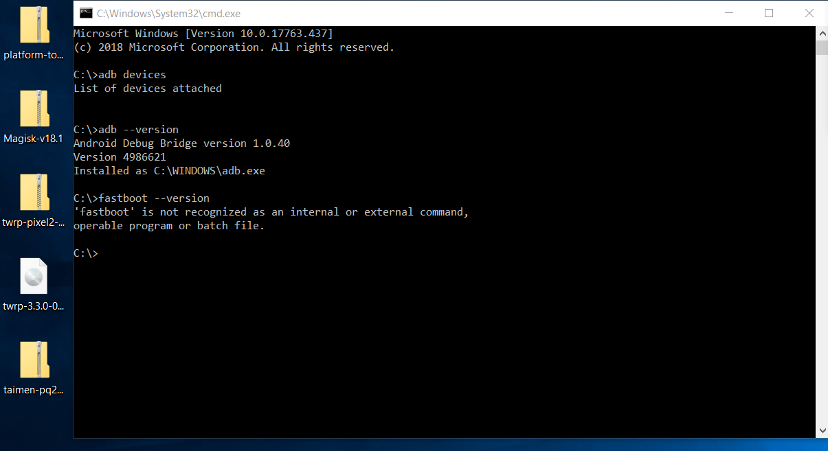

Now you can see what i'm up against.
Yeah, you're not running the commands from the right directory. In command prompt type:
cd desktop
Then type:
cd platform-tools
Your command prompt should look like:
C:\platform-tools> "type command here"

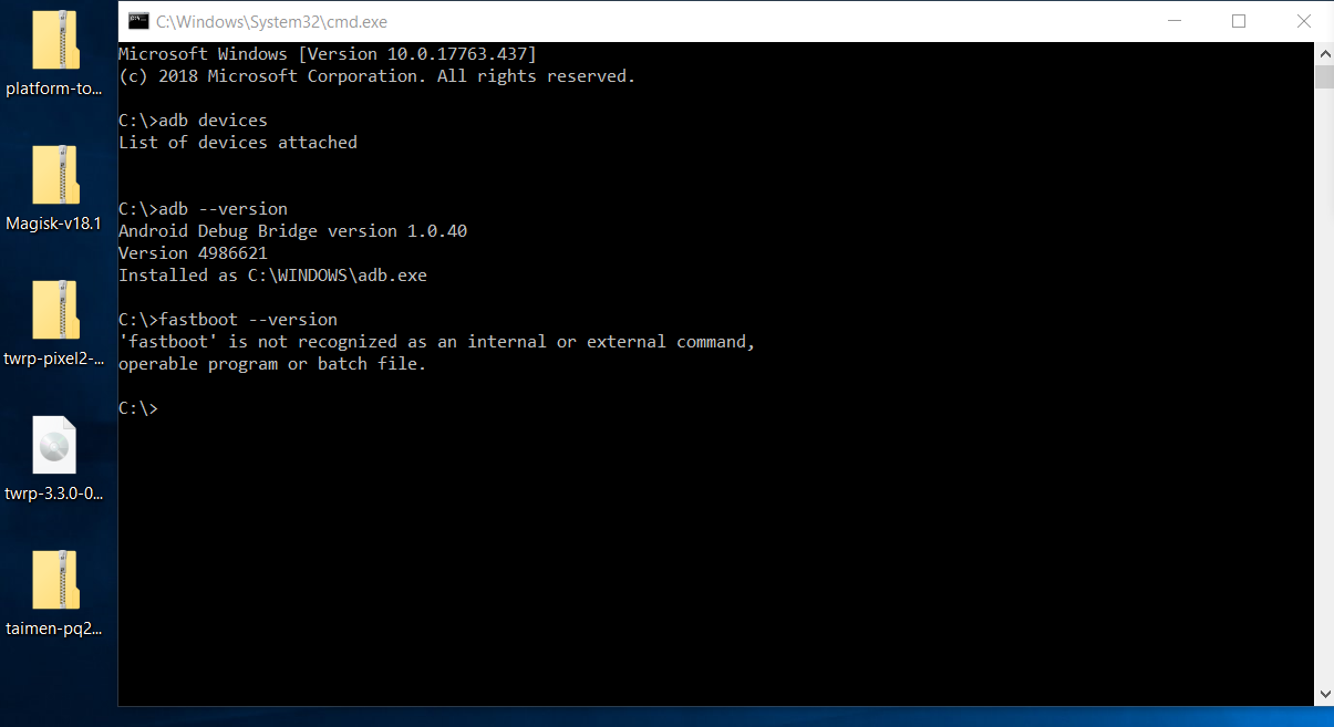

Here's another one. The only way that i can get the number underneath adb devices, is if i take the phone out of bootloader mode. Is it possible that we can pick this up again tomorrow? I really do appreciate your help, but i'm kind of beat now.
That looks like the same screenshot to me. Still looks like the commands aren't being run from the correct directory, unless you uploaded the wrong screenshot?

But you should be able to root with a critical or normal flashing unlock. It really looks to me like your command prompt is incorrect. It looks like you aren't running the commands from the right directory.

Did you try changing the directory like I mentioned above?
Your command prompt looks like this:
C:\> commandgoeshere
It should look like (assuming your platform tools are on the desktop from your screenshot):
C:\Desktop\platform-tools> commandgoeshere
Basically, your command prompt needs to be running the commands from the exact location that your platform-tools folder is located.
If you're on Windows 10, which it looks like you are, you can alternatively open the command prompt and then type: cd [hit the space bar] then drag the platform-tools folder into the command window. It will fill out the path. Then hit the enter key and your path should be updated.
