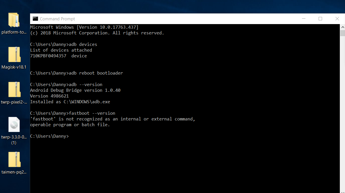

Now, i'm totally lost!
You need to extract the contents from that zip file. So on your desktop there's a normal folder named platform-tools that contains all the files that came inside of it

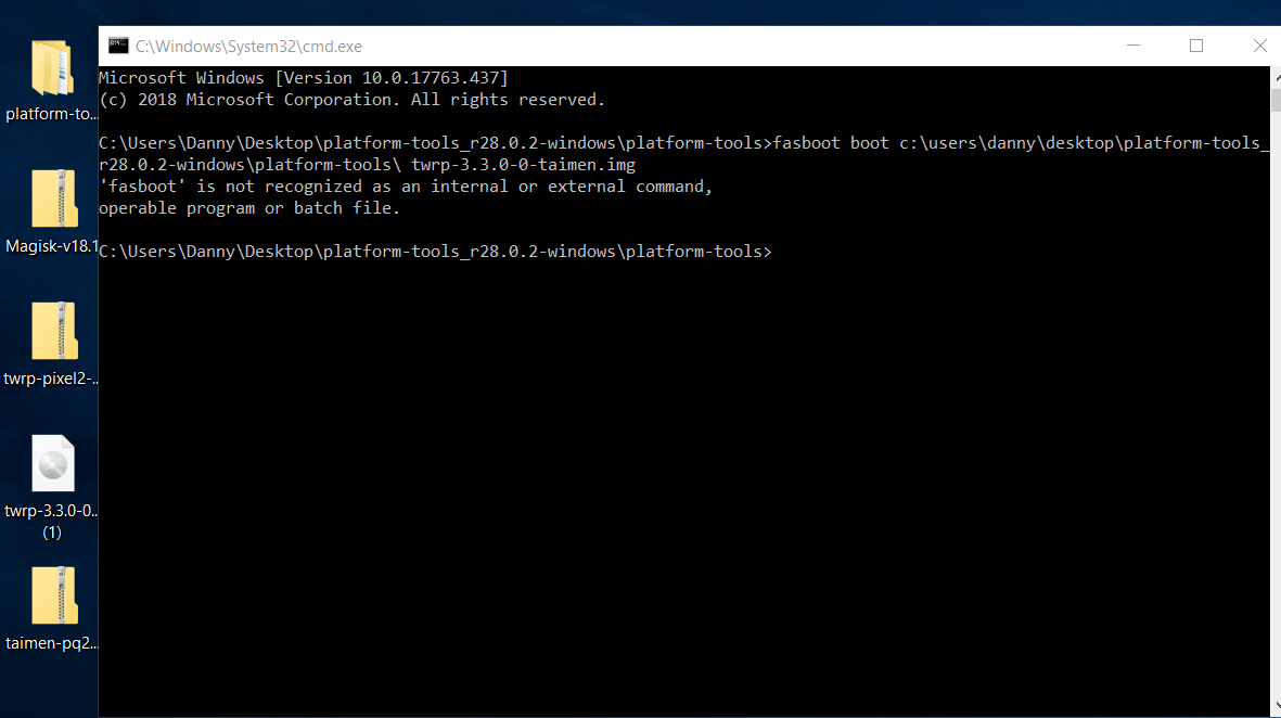

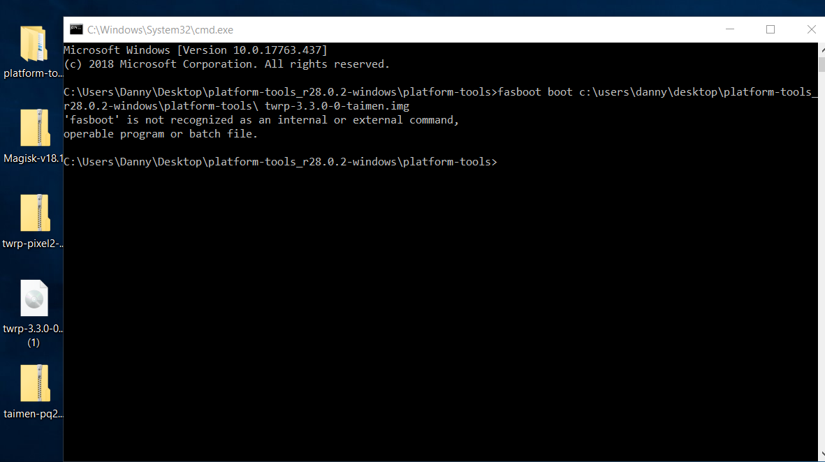

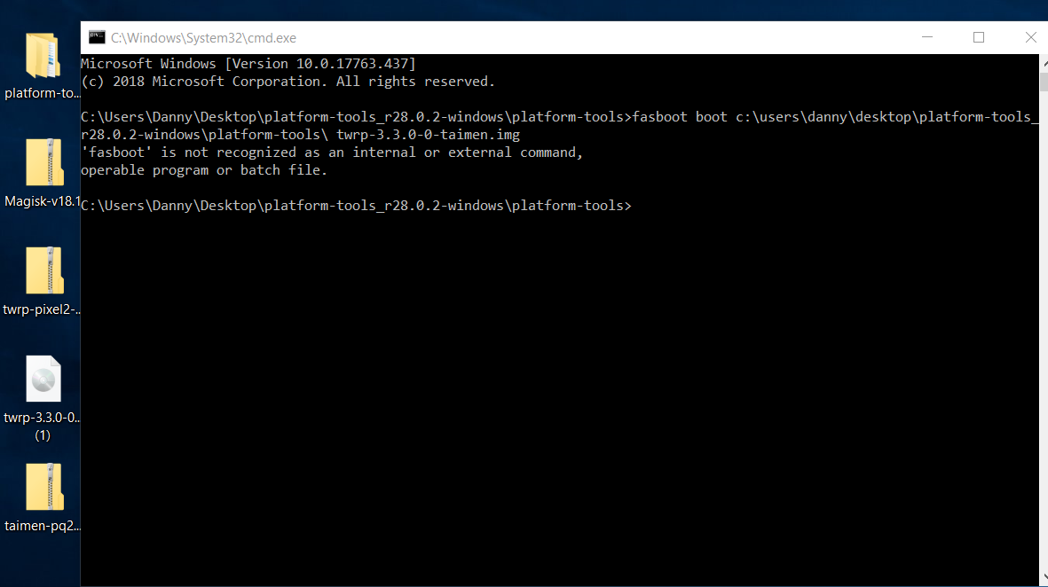

I was told that this root was much easier than the Nexus 6. I don't believe it. Two days now, and i'm still not rooted!
is that twrp.image sitting alone on the desktop, or is it put into the platform-tools folder?
ok so it looks like u got adb opened in the right directory next you need to do fastboot but you are pointing the command in the wrong place it should be:
Code:
fasboot boot c:\users\danny\desktop\platform-tools_r28.0.2-windows\platform-tools\ twrp-3.2.3-1-taimen.img
you could have just created a folder on your desktop so that the path is much shorter....lol
edit: because your path is so long you have to scroll the code box dialog
Code:
Code:
I did create a folder on my desktop. I unzipped the platform-tools folder and put it on my desktop.
yeah but you dont need the platform tools folder to use adb commands, you just need adb command and a few files that was extracted from the platforms tools. you can put those in a folder named rooting or something like that. your path is like a folder within a folder that's on your desktop.......its fine.....its just a lot to either copy and paste in or type in is all......lol
main thing is you now have the correct path.
