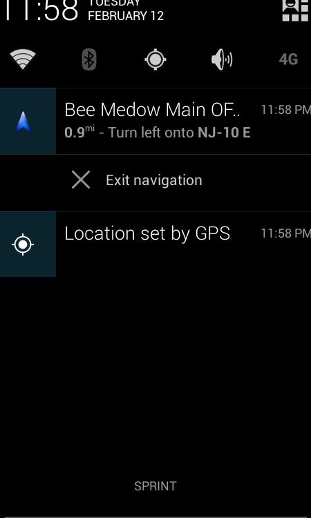

SelfElevated2.... Give this a shot go to settings, baked settings, prop modder, then check off fix permissions... Ps... Location services/gps was on but not working while I did this... Once u check off fix permissions reboot into recovery and wipe both caches. Then reboot back normally. Once u boot up again open ur navigation or maps and see if it works. Seems to be working for me.

Your on WiFi bud. Turn that off and then try to get it to say location set..I told you WiFi will get you a location. It's when your not on it that counts
I couldn't test it anyway mine works. I followed my own advice and got a lock before flashing. Thats why I just reflashed before helping you root that night
And LOL because you look like you're from new Jersey with the accent and all:p
Notice I'm not on WiFi but I am on Blackman with a instant GPS lock
