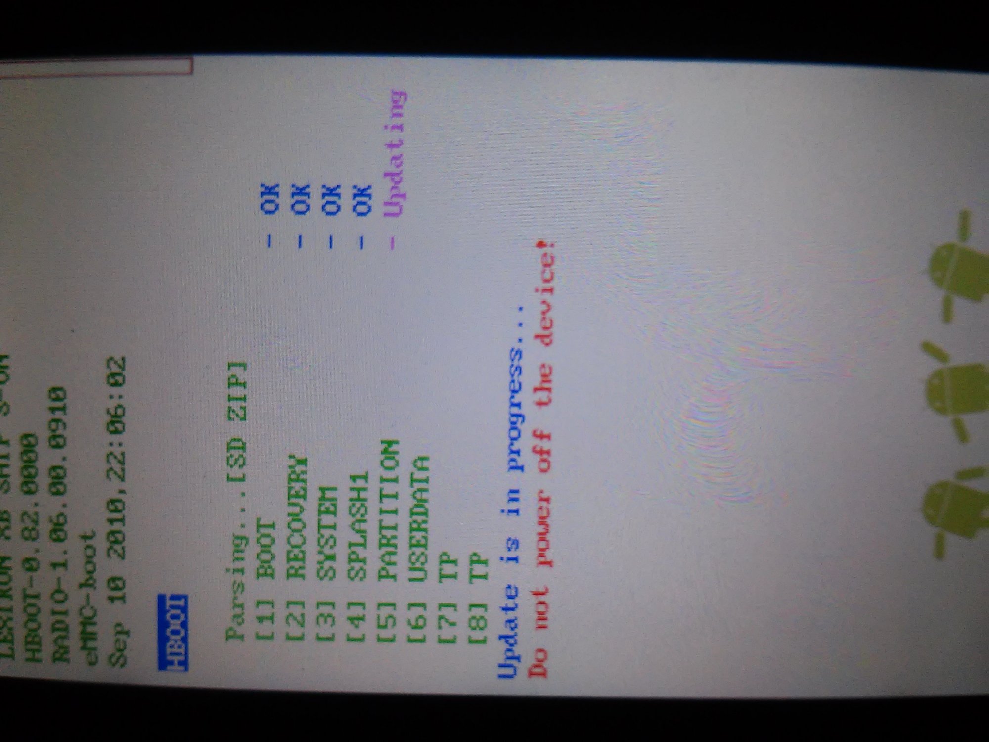

Hboot checked and downgraded and is now attempting to install the vzw ruu but it is hanging at partition and has been there for at least 10 or more minutes, is this normal? Once this is done and I do the s-lock step and install my GB custom RUU do I unlock the bootloader directly after so I don't reformat the phone over and over? will I still have twrp after as well, that seems to stay persistant but locks the bootloader when I use it. Sorry for 20 questions, I'm just super happy to get help with this!! =)
10 minutes is a pretty long time,what partition is it? hopefully its moved past that by now and youre on your way.

It is still hanging, it's been an hour now. What should i do? I don't want to brick it, i think i will go with the recovery you recommend :)
since the partition is not hboot or radio,id go ahead and pull the plug. plug it in and make sure its got a full charge,then do a factory reset from hboot. you can try and let the phone boot,if you want.not sure it will without the rest of the partitions being updated. it may boot,but have issues.
after the factory reset,try and run the ruu again. you are attempting to flash the vzw downgrade ruu,correct?
Yes, even though I pulled the plug and rebooted, I took my sd card out and factory reset in hboot, the verizon rom booted up and now I am going to run the s-off commands and flash the custom GB and unlock the bootloader at least for tonight =)
