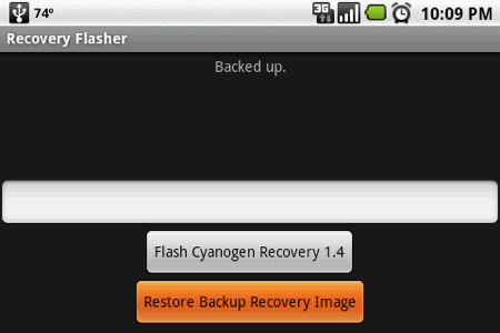

Can someone explain steps 11-13 from the guide?
So after I use FlashRec to back my recover image, what does step 12 mean? Is there a button/option in FlashRec to download a different recovery image than the one I just backed up?
Also, once I get to step 13, how exactly do I flash the new recovery image? is that another button/option in the FlashRec app?
11. Launch FlashRec. Use it to back up your recovery image.
12. Download the new recovery image from FlashRec
13. Flash the new recovery image.
Once you have backed up your recovery you'll have the option of installing a new one. You can download one and put it in your sd card with flashrec.apk.
Step 12 allows you to download a new recovery, since you have one stored in your sd card, just type in the address of your recovery and install it.
This process is explained in a video by unlockr.
I can't view that video at work, but after reading the instructions on that unlocker site it sounds like I have the option of either using a different recovery image (like the Amon Ra’s Recovery Image), or clicking the "Flash Cyanogen Recovery" button like the one in this image below?? If so, what is the advantage of using the Amon Ra recovery image vs the built in Cyanogen recovery?
