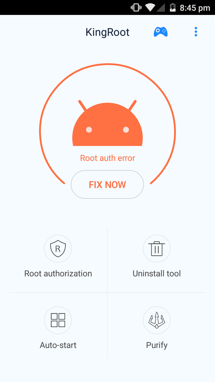

Got a new outcome in running the newest version of Kingroot apk. Not really a positive thing though. After a couple failed root attempts, King root did power off my phone, only to have it stuck in a boot loop when it tried to restart. I did get it to boot to recovery menu, however the only option from there that worked for me was the factory reset. Just putting this out there for a potential word of warning for those that try every version of Kingroot that comes out,like me.... It is something new and different, but not really in a good way. Hope you all have better luck than I did!
Has anyone tried the PC version? Does kingoroot update the app and pc versions at the same time?
No you can't and you can get temp root with kingoroot PC only....The app just restarts your phone like its rooting it but with this phone we can't get the System Writable to finish writing the root to make it Perm. I'm in the Process of trying to get a Max or Grand Max ....I can't take it not having full root of my phone.
I used KingRoot a little bit ago. I suggest not using it right now unless you want to hard reset. Luckily I backed up my phone just in case. It will give a "temp root" I guess but once you restart it will not boot.

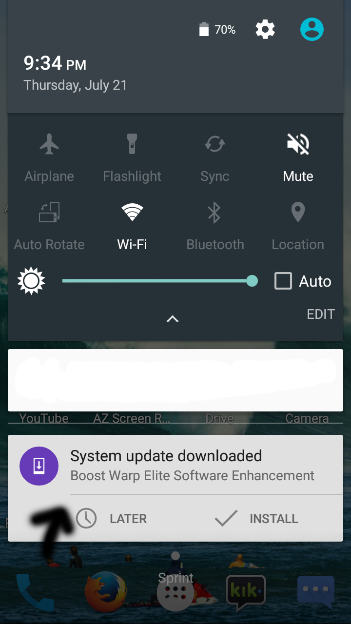

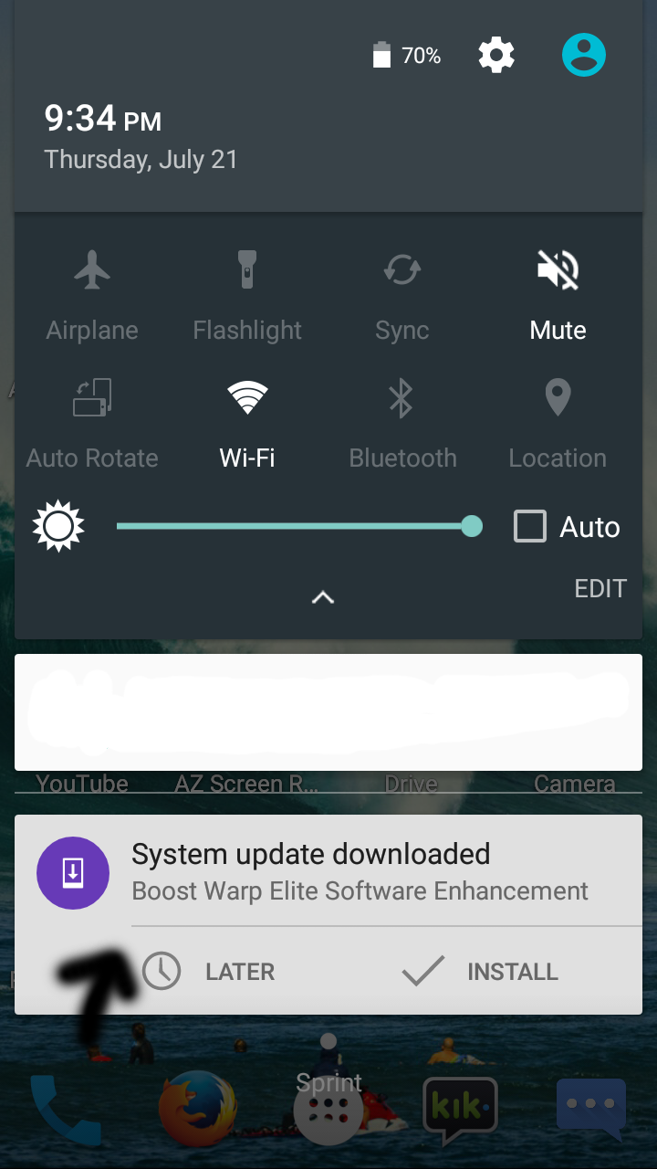

Is there a way to remove the update notification?
So it looks like an update was released on 7/20 per boosts phone update page. It just says Android security patches. Maybe someone can get the update package and find out a way to use the vulnerability it patches to get us root.

Everything seems good now, but I did start getting the update alert that @iamjohnm was mentioning. Very odd since I was trying to check for this update before reset and couldn't get it. I did go ahead and apply the update. After a long install, I tried the kingo apk (away from a windows machine I can run the desktop version on) with no luck.
