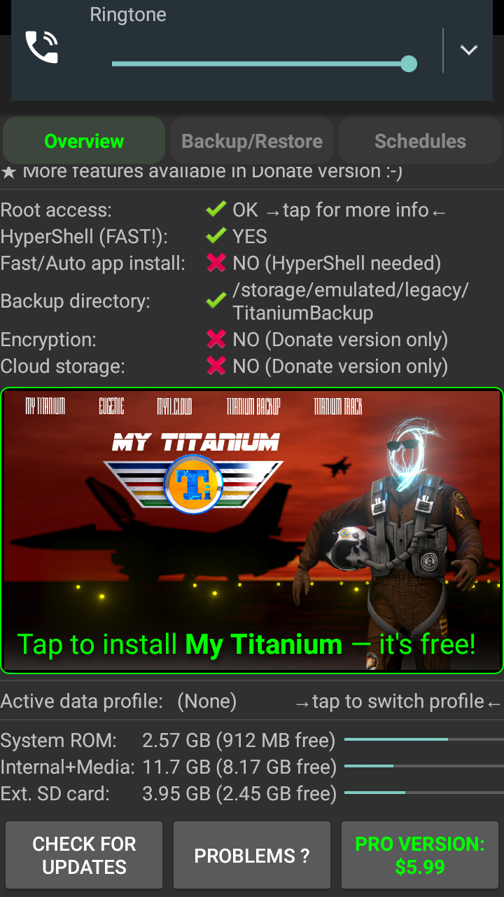

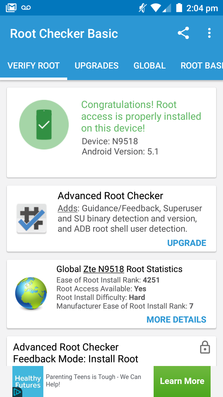

I hope this is the right place for this sorry if not. I have searched throygh the pages here, but thought asking to make sure wouldn't hurt. I just picked up the Zte warp elite n9518 and I am wanting to root it to get rid of all the bullshit they put on it. Is the root guide sticky the right one for this model. And if yes, should I be worried about it freezing like the guide says?
Thanks y'all
