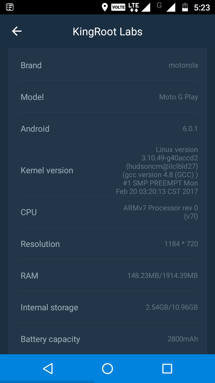

Unlock the bootloader, flash Twrp, flash SuperSU. Remove the unlocked bootloader warning by flashing the logo.bin and profit.
